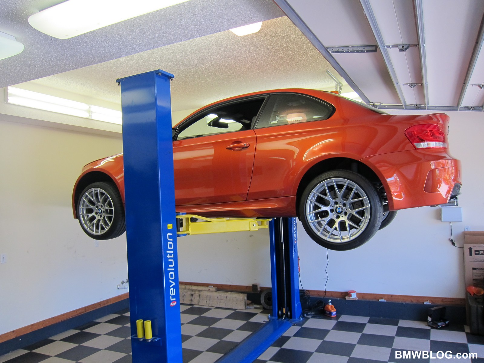

First order of business is to drive the car to get the oil hot. Oh the pain! Once done, we pull it into my garage to put it on the lift. If no lift, jack stands or ramps will work just fine. Once the car is in position, I first open the hood and take the the old oil filter out. The oil filter removal doesn’t have to be first, you could drain the oil first, this is just the order I like to do it. For those with Obsessive Compulsive Disorder, you should remove the residual oil in the oil filter housing.

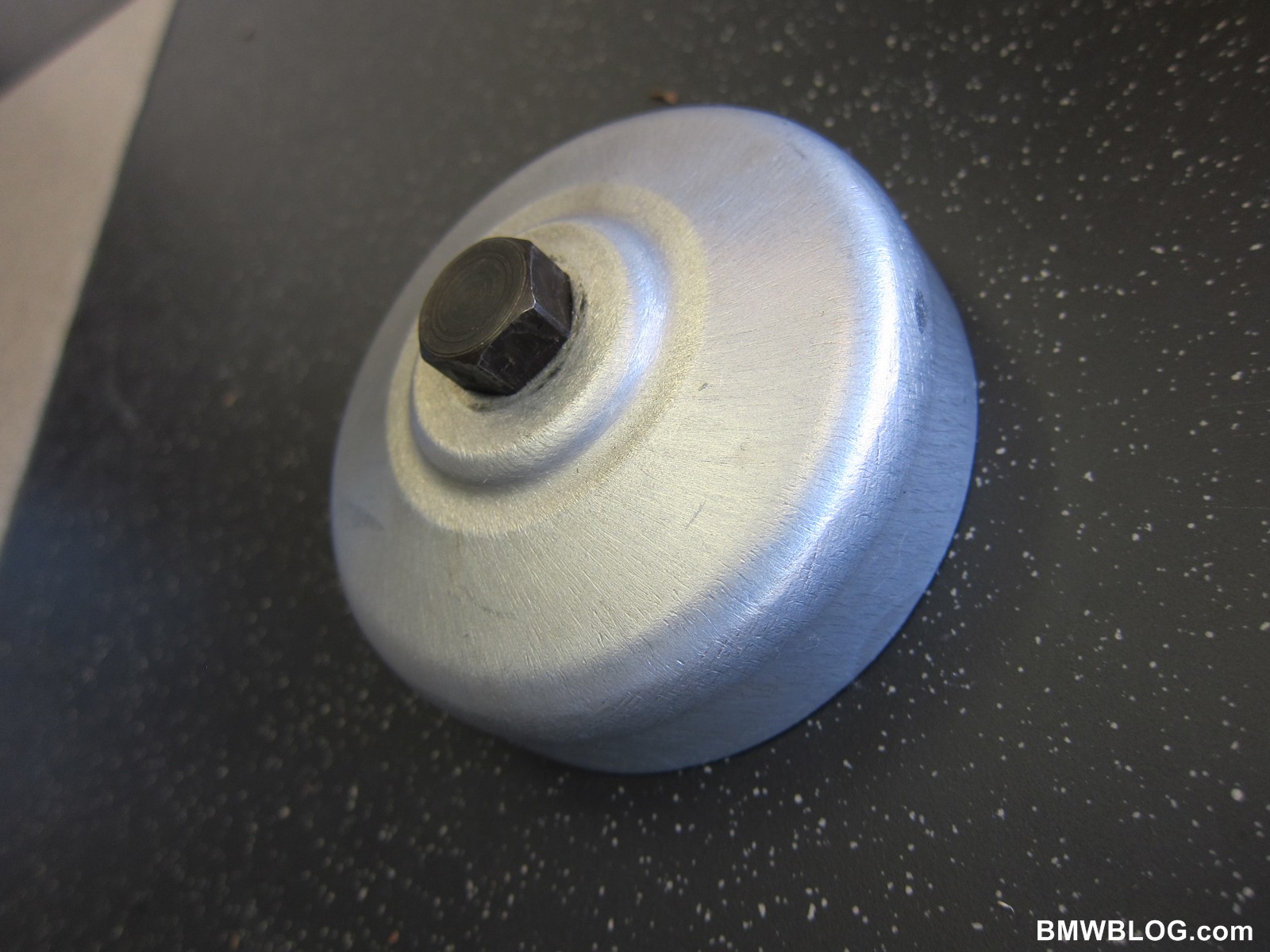

Over the years, BMW has made simple things like an oil change harder and harder for the do it yourself’er. On E36’s like my old S52 M3 you can use 13mm socket found in any tool box to remove the oil filter. They upped the ante on the e46 M52 and M54 motors and made me go buy a 36mm socket. With the e90 and N52/54/55 motors they went off the deep end, and now you have to special order a cap that fits over the black plastic oil filter housing. Grab it with a channel lock pliers and you are going to mar it severely. Fortunately, Bavarian Autosport sells the Special Oil filter housing cap for $15 and it comes with a 17 mm six sided hex head on the top, which interestingly is the same size as the oil drain plug. Ha!

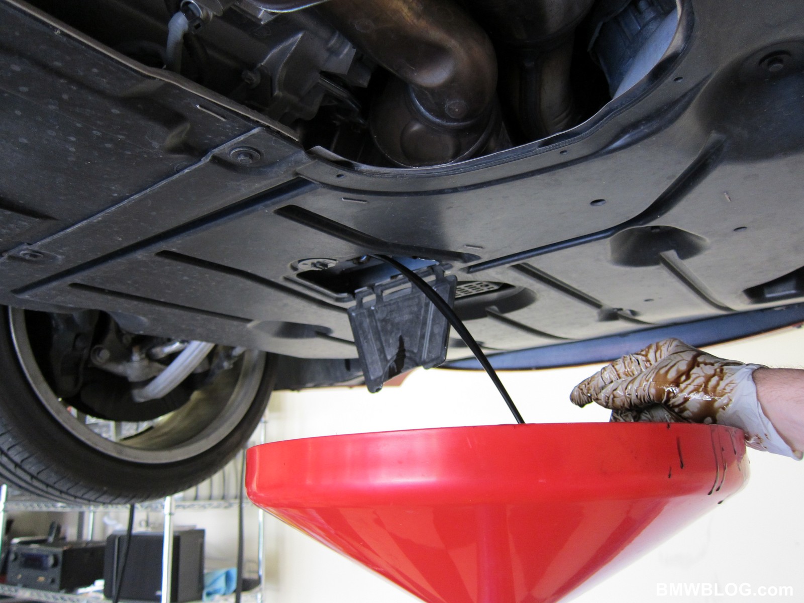

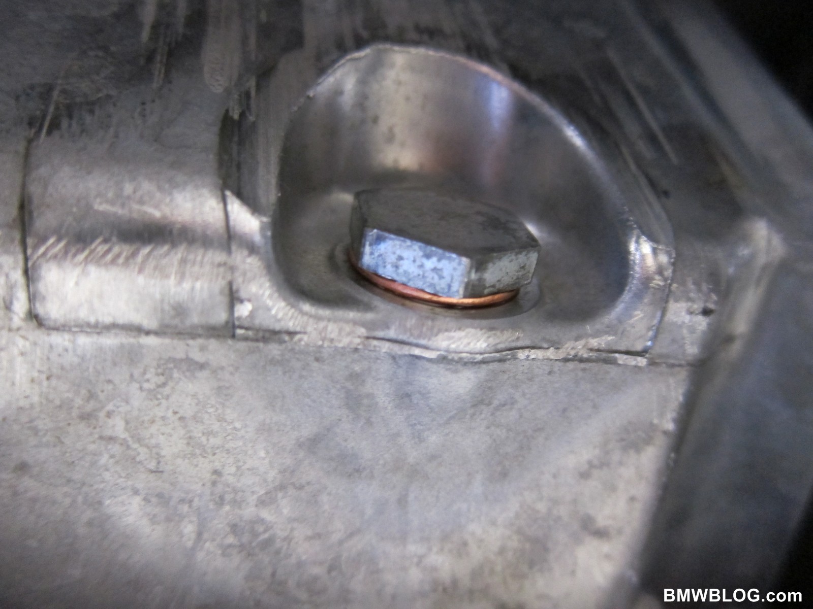

Once you are up under the car locate the small trap door in the splash guard. Get a large screw driver and rotate the lock 180 degrees and the the door will just swing down. This trap door is pretty cool and will hopefully stand up to repeated use unlike some of the earlier generations where parts were easy to loose or break leaving a lot of shops to simply remove your panel and not tell you. Once the door is open it will expose the 17mm six sided drain plug that opens towards the passengers side front tire. I use a 1/2″ drive six sided 17mm socket to loosen the bolt but you could use a 3/8′ths socket too. I like the six sided sockets because I feel like they are less likely to strip your plug. Loosen the drain plug till its almost out.
Now comes the tricky part. Not getting oil all over your hand – which you’ll see in the video I didn’t do a very good job of. I usually like to use a socket with a short extension, but that combo doesn’t fit in area BMW provides inside the trap door.
I like to let it drain for a while even with heated up oil. Once the oil has stopped draining, you can install the drain plug back in but make sure you’ve put the new copper crush ring first. Torque to 25 Nm. You want to be careful not to over-tighten and strip out your oil pan.

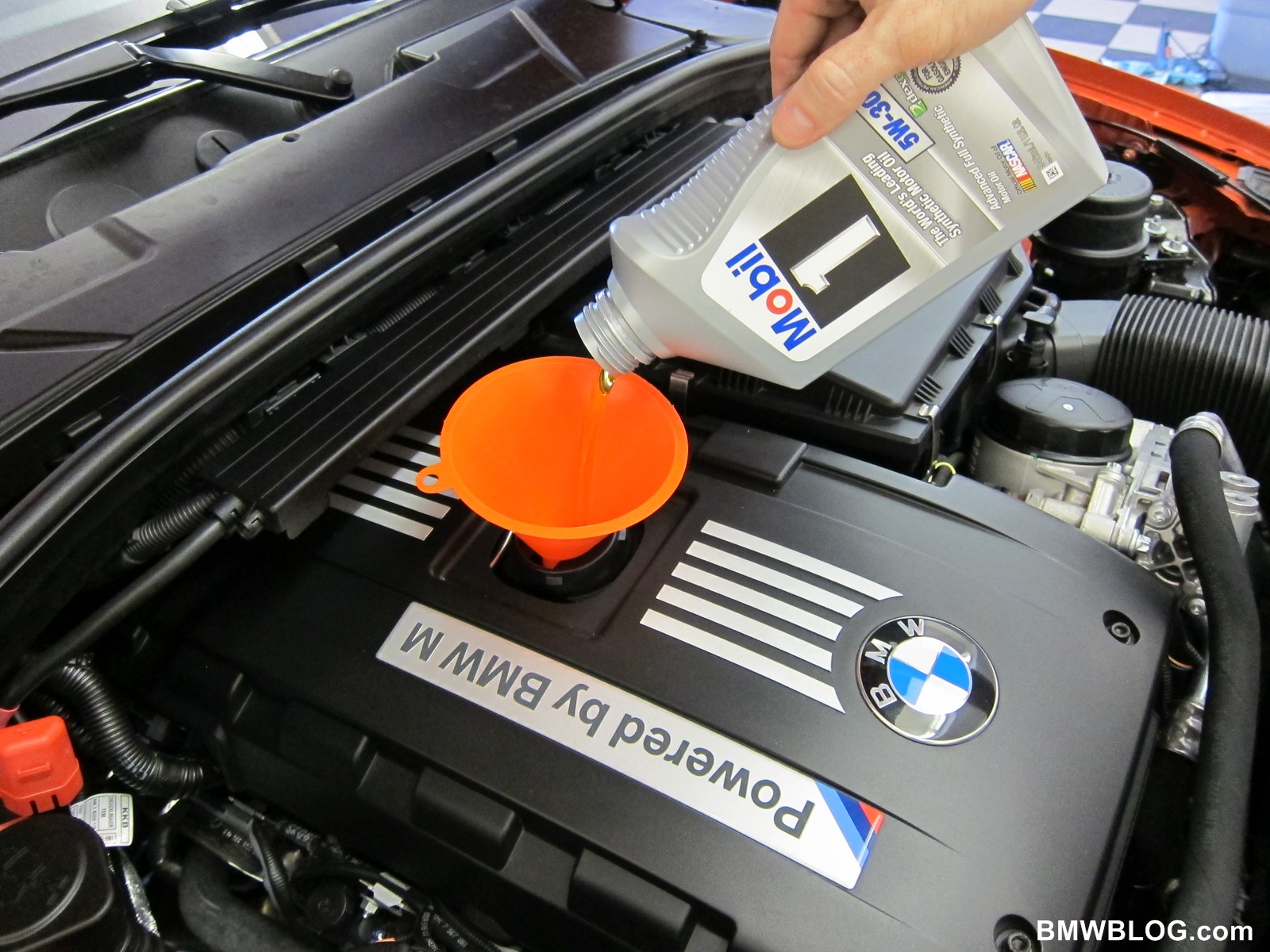

Finally, add 6.9 Quarts of synthetic 5w/30. I use a clean funnel so I make less of a mess when I add oil to the 1M. When cleaning up make sure to take your oil to be recycled. The local autoparts store I use has a recycling container and don’t charge for disposal.
