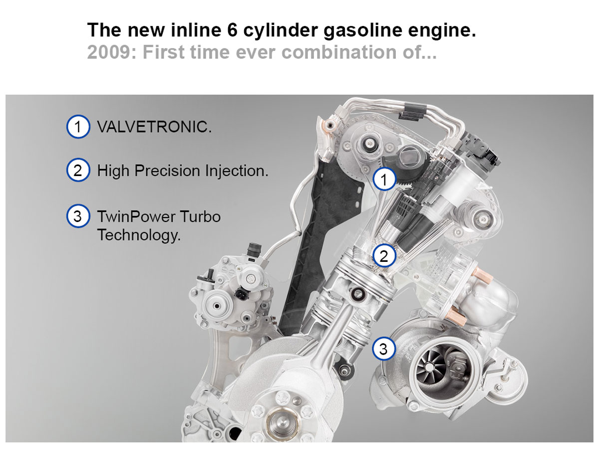

BMW uses Valvetronic to provide variable lift to the intake valves of an engine. It utilizes an intermediary between the rocker arm and cam lobe whose shape is designed to change the total lift of the valve depending on its position in relation to the rocker arm and cam lobe. This allows for a variable lift profile, within a specific range, unlike the original VTEC which is a simpler (yet effectively clever) solution.
So with double-VANOS, Valvetronic and port fuel injection we have the foundation technology for the N52B30 engine familiar to NA BMW owners as the x28i models.
But let’s take that basic suite of engine technology, enhance the performance and miniaturization of the Valvetronic components and add direct injection and forced induction like the N54B30 and you have a recipe for real success.
Direct injection works well in an engine that allows significant variations in valve timing and forced induction. Since it must deliver fuel directly into the combustion chamber, it subsequently utilizes higher fuel pressures than port injection to overcome the pressure of the compressed air charge in the cylinder. It is a key enabler in the new round of emissions compliance and fuel economy requirements that would otherwise inhibit engine performance.
One more piece of technology merits a brief discussion and that is the Twin Scroll turbocharger used in place of the twin turbochargers used on the N54B30. By using a single turbocharger, that maintains exhaust pulse separation ahead of the turbine, an exhaust pulse reaches the turbine every 120 degrees of crank rotation rather than every 240 degrees of rotation for the dual turbocharger setup on the N54B30.
Coupled with Valvetronic and VANOS, direct injection and the twin scroll turbocharger, BMW provides the same performance across a wider RPM range for less fuel consumption in the N55B30 than the preceding N54B30. Quite an accomplishment.
