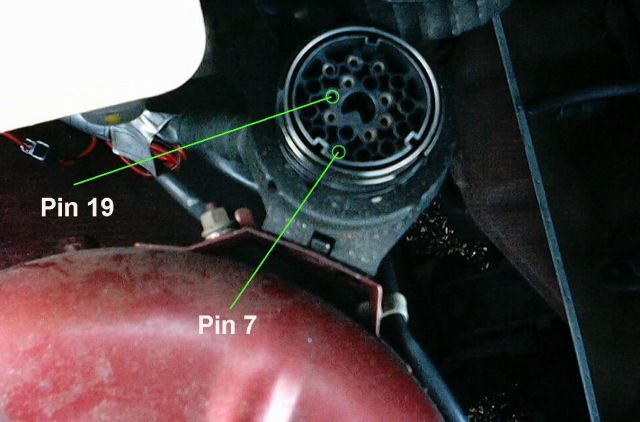

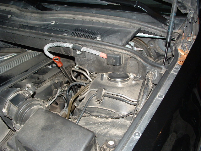

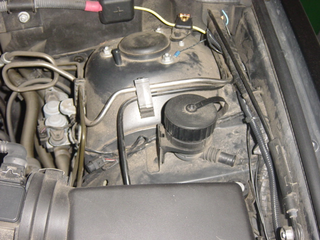

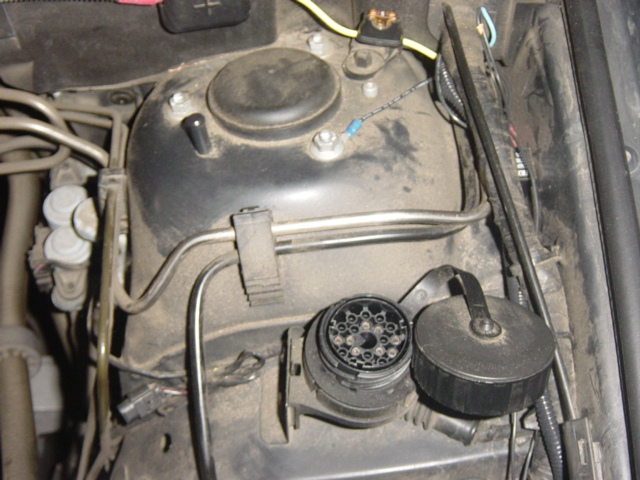

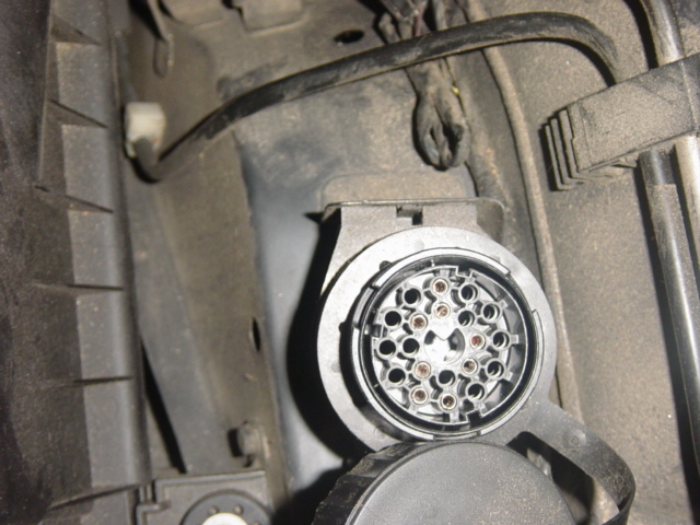

Resetting the service lights can be done by one of two ways, firstly specialist tools are available for around $95+ that plugs into the diagnostics port and reset the lights automatically, or you can do it manually using a paperclip or small length of wire. To do it you need to unscrew the dust cover from the diagnostics connector (attached the the suspension turret ) and turn the ignition switch to position two - this is where the accessories come on but the starter motor doesn't engage. Create a short between pins 7 and 19, hold this in position for 5 seconds for an oil service, or 10 seconds for an Inspection. See the picture below - looking at the orientation of the "pacman" helps.
Take off the piece of wire and turn off the ignition. When you turn the ignition back on you will see the service lights are all green bars.
One way to make a jumper is to use a 16 gauge wire, stripped on the ends, twisted and then folded over once to make it thicker. Just make sure you don't touch any of the other pins when one is already connected.
The light reset is done not just by time of "jump" of the pins but by breaking the circuit after the correct time. To reset Oil Service lights engage for approximately 5-6 seconds then release. For the Inspection lights, engage for approximately 10-12 seconds then release.
